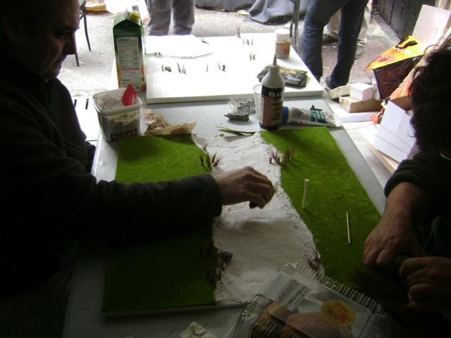

    If you use large polystyrene tiles, 2 cm or 3 cm or 4 cm thick on your gaming table, you can carve it into them.

    The advantage of using thinner sheets is that you can cut them in two rather than carve into the thicker foam – drawbacks are that you can get hard spots from the glue and parallel horizontal lines.
    I’ve found grit / plaster coating the edge can help disguise the lines and really helps if you use leopard spotting painting.
    #190423
    Or the other option: thin tiles, or a painted board or whatever, at the bottom, and all around would be the thicker tiles of the rest of the gaming table.
