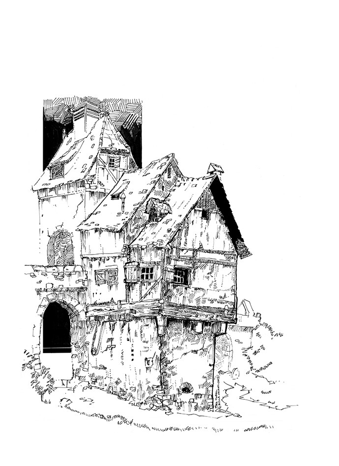

    I’m going to be making buildings for 28-30mm figures, so I’m going with 5mm = 1 foot (would that be 15mm = 1 meter then?).
    It’s not going to be fancy by any stretch of the imagination.  I’m going to be using cork tiles for the walls, blue/pink insulation foam cut up as stone blocks, balsa strips for beams and lots of card rectangles for roof tiles.  Like I said, nothing fancy.
    But this is a new period for me terrain-wise, and am excited to get started this coming weekend.  I would be very happy if they ended up looking like this, but much simpler of course:
    https://openclipart.org/image/2000px/313024
    http://codstickershistoricals.blogspot.com/2023/05/a-scratch-built-cottage.html
