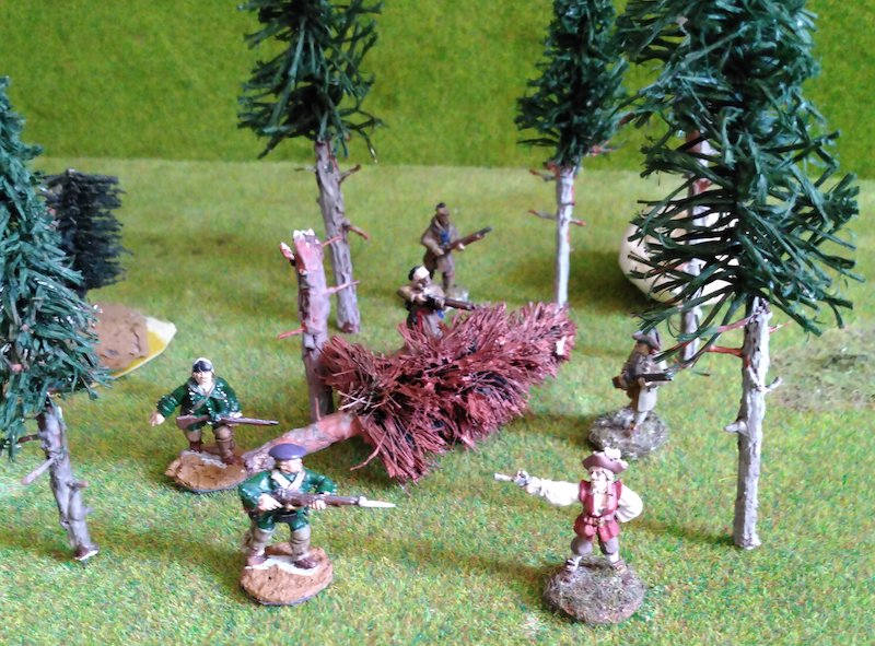

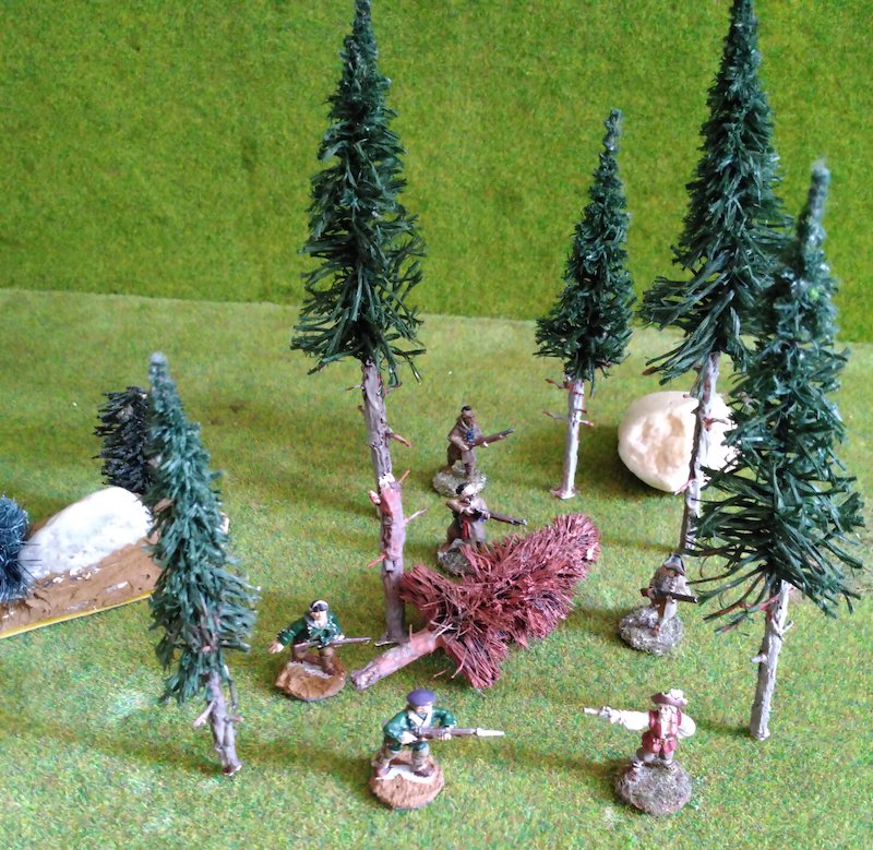

ParticipantFor FIW skirmishes I need something that looks like open forest, a forest easier to cross on foot (except in close order) than the rather dense European forest of the usual rules.
Mainly pine trees, with bare trunk bottoms. Not a very precise scenery, just something that gives an overall effect.
(28mm figures for scale, real trees can be much higher, perhaps I’ll make a few taller ones but it must be practical for gaming.)
A few big rock and bushes, and fallen or broken dead trees, will add more cover in random places.

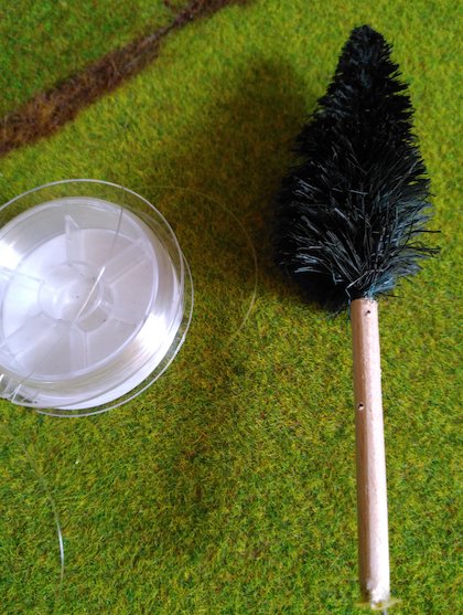

I use miniature pine trees fixed on the top of wooden rods. They look better with a few dead branches on the bare lower part where sunlight does not reach them (no joke intended). I drilled some holes in the trunks, then I tried to make short branches with metal wire, but there was a danger of harming the players’ fingers and (what would be much worse!) the paint on figures when moving troops between the trees. Also tried string, but it’s too slack. For the moment I’m using fishing line (which I bought especially for this, I don’t fish) it’s strong and flexible enough. Then the whole lower trunks, including these few branches, receive a rough layer of wall covering and cheap acrylic paint.
Still need to improve the colours, and also to decide what the ground should look like, the green field grass on the pics do not fit well in a forest.

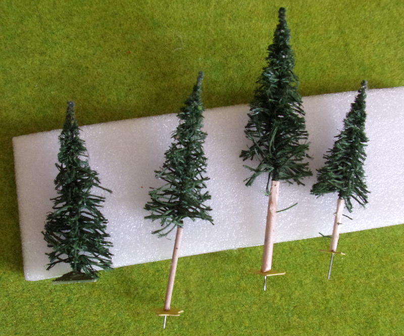

ParticipantAre you jamming them into the table? :O
We use polystyrene boards (60cm x 120cm, 30mm or 32mm thick) and polystyrene hills. Most trees have a thin wire pin underneath and are randomly stuck into the terrain before the games, through the green “grass” or brownish “ground” covering the polystyrene. Some others trees (not those on the pics) are glued by 2 or 3 on card bases.
