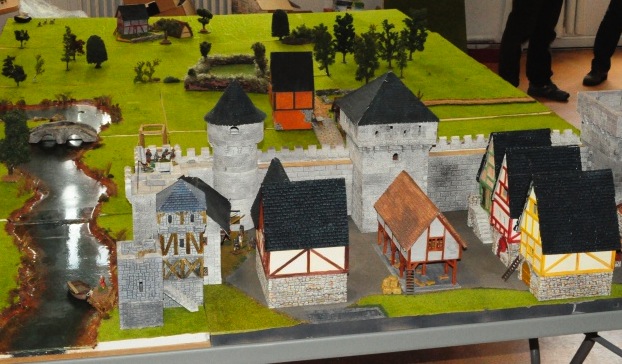

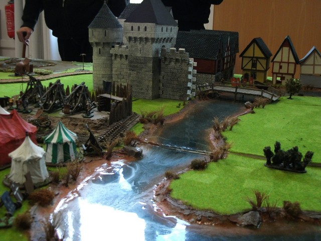

19/08/2016 at 11:04 #46893Patrice
ParticipantSome rivers made by members of my gaming group (…not by me, if that can comfort Sane Max!)
We use 120 x 60 cm and 60 x 60 cm tiles, 30 or 32 mm thick.In the following case the coating had shrinked when the liquid was poured on it, it caused unexpected ripples:

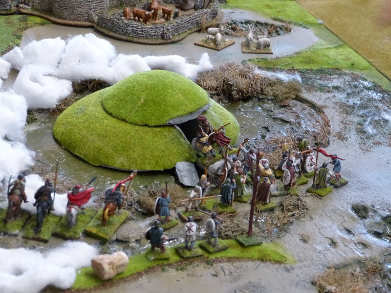

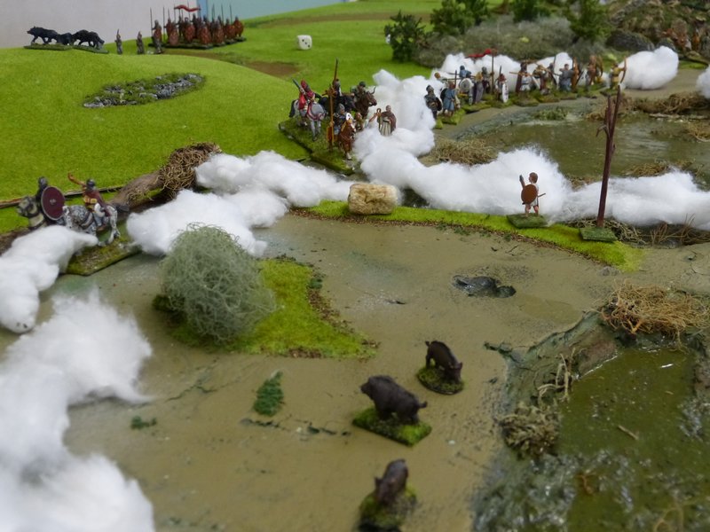

A marshy area. The white cotton was magical fog in an Arthurian scenario…
…and was concealing an objective which suddenly appears!
