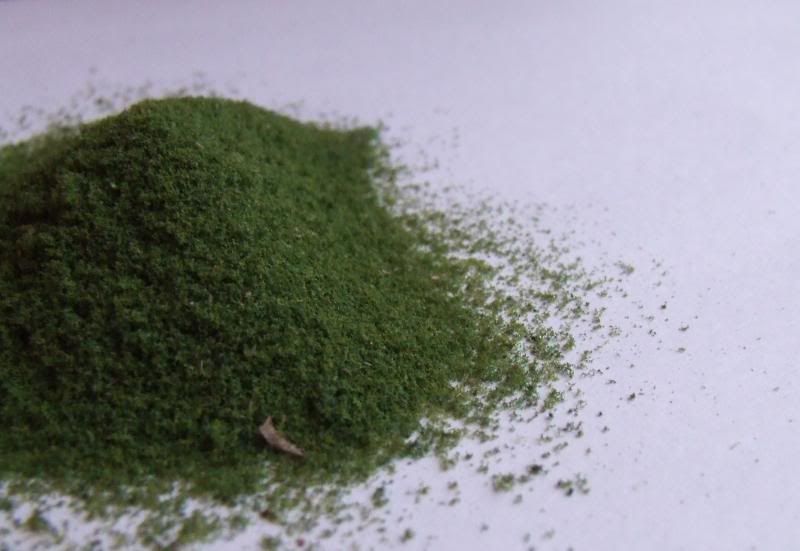

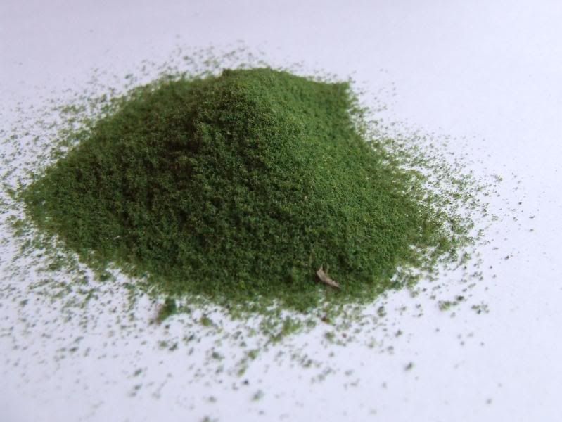

    Foam
    This scatter has an almost foam like quality.
    I used this for a chap who wanted some bases flocked to be all the same colour but not too featureless and dull looking.
    It will adhere to a wet painted green base without having its colour altered.
    (It does not soak up the paints colour)
    In the zoom picture you can see that each ‘flock’ is uniform and almost square.
    Its appearance is not affected when PVA is used to seal it.
    It is quite easy to apply by sprinkling on by hand.
    I feel it is the most universal of all the types that I have used.
    £2.00 per pack

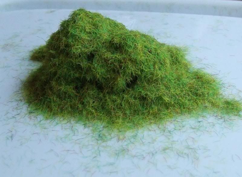

    Static
    This scatter has an almost plastic like quality.
    I use this as the final thin layer on my bases and my terrain tiles.
    It will not adhere to a wet painted green base as well as the others.
    In the zoom picture you can see that each ‘flock’ is almost hair like.
    Its appearance is affected when PVA is used to seal it as I find it flattens it down.
    This is also quite easy to sprinkle on by hand.
    I feel it is best used on 15mm scale projects an above.
    Prices vary but I have seen it as cheap as £4.95 for a massive bag.
    Be careful as lots of people charge a lot for this.

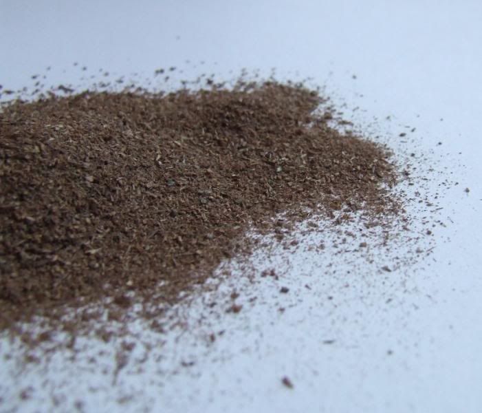

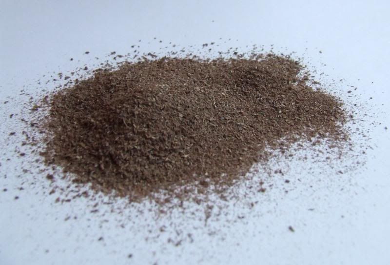

    Wood
    This scatter has wooden / sawdust like quality.
    I use this for all my dirt/earth flocking.
    It will adhere to a wet painted green base as well as the others but it is very likely to suck up the paint and change colour.
    In the zoom picture you can see that each ‘flock’ is random, there are thin bits, thick bits, small bits of untreated wood in there, it is the less well finished but that is why I like it so.
    In the bottom of the bag you get a really fine collection of the flock, which is almost dust like in quality, great for fine detail especially as I do 6mm.
    When it comes to sprinkling by hand it is fine but it does stick to the hands a bit.
    Its appearance is not really affected when PVA is used to seal it.
    Prices vary but I have seen it most often at about £1.95 a bag.

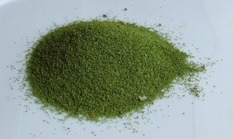

    Sponge
    This scatter has a foamy spongy like quality.
    I use this as my base coat on bases and put the static grass on top.
    It will adhere to a wet painted green base well but it is easily discoloured as it is after all sponge like.
    In the zoom picture you can see that each ‘flock’ is almost like a minute torn piece of sponge
    Its appearance is affected when PVA is used to seal it as I find it pulls it down and hardens it.
    This is the most messy to sprinkle by hand, it sticks to the skin and gets a bit damp almost.
    I have seen this commonly at about £2.95 a bag.

    The static grass is good value and best as a final layer.
    The foam is a good solid all round performer.
    The wood is good for small areas of detail only, as it does look quite wooden.
    The sponge is the most versatile but the trickiest to use.
